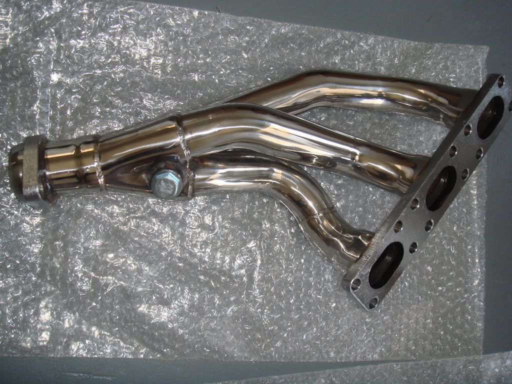

    I'm ordering these ebay headers for a m52 swap and wanted to get thumbs up from someone who has done it before.
    Will i have issues with these or should I get a efferent set?

    I used a different set so I can't say if those will work.

      These are some that I was looking at for my s52 OBD1 swap
      http://cgi.ebay.com/ebaymotors/BMW-E...item29fee1b3da
      Very similar looking.

        that's what I'm using with no issues

            I have headers that are almost the same as these. They are working great but I got mine for 100 bucks to my door.
            www.gutenparts.com

              Raceland sell them for $100, but don't know how much shipping is and I have no experience on how they fit lol!

                These fit perfect no mods they just need to have a center section fabricated to work with whatever rear section you are using.

                  i have the same ones, just need to remove the heat sheild off the engine mount arm and they fit perfectly. line up great underneath and easy to add on the rest of the exhuast system too....

                    Just send the guy an offer 25 or 50 bucks less. They will most likey take it and you get a really good deal.
