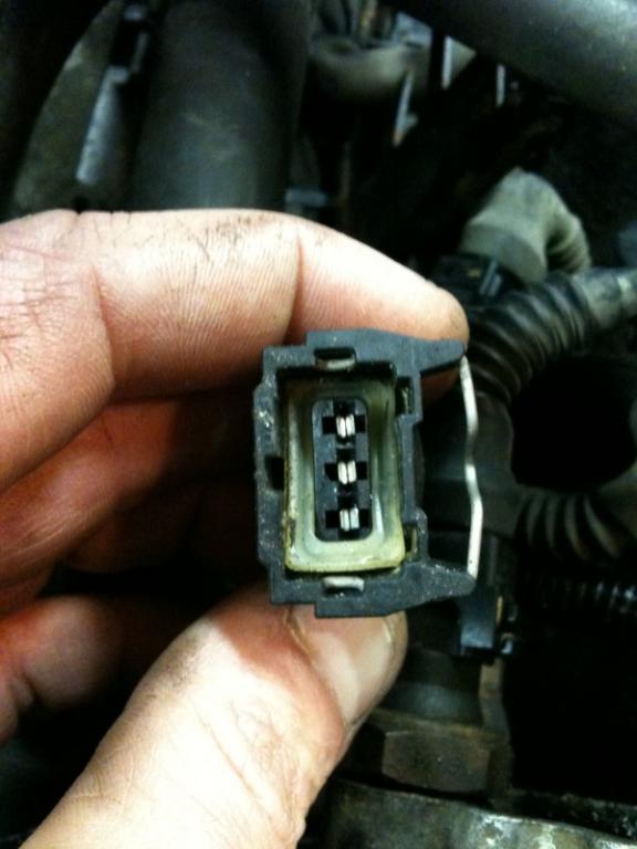

    What is this for?
    93 M50, this plug is under the intake manifold and is not plugged into anything. Any ideas??

    What color are the wires going into it?

      ICV? (idle control valve) should be located behind throttle body on the intake manifold

        TPS?? i know my DOHC m42 has a 3 prong just like that

          TPS. Install your throttle body and it'll be obvious.

            white/green, red/white, white/yellow
            Throttle body was never taken off.

              Start looking at diagrams its simple see whats not hooked up. Is there anything else with those wires?

                i was nice and had a peak at my ETM and it is indeed the ICV.

                  Thanks MattM. I started to look at mine and just confused myself more. I need to spend some time and learn how to use it.. The ICV is bolted to the throttle body, correct? I will grab the laptop and hit the garage this afternoon and try to get dialed in on the ETM..

                    its on a hose off the back of the intake manifold, behind the throttle body

                      Alright. I found the icv connected to my boot in a box. Ii seems the end is broken where it goes into the intake, are number 9/10 the right parts? I am pretty sure they are, they look right but realoem doesnt have a diagram with the whole assembly attached. Thanks

                        yup, 9/10 connect the hose to the back of the intake
