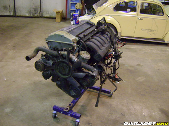

                  according to the seller in Denver the motor is a Vanos motor and has the bump on the valve cover for the Vanos. He also explained that the 92 was the only non vanos motor.
                  1991 e30 328i M52 swapped: Gone
                  1995 e34 540i/6 1 of 76 Clean
                  1985 e28 euro 525i the daily
                    Here are some pics if anyone can confirm for me before i drive 6 hours.
                    pics..
                      Ok, you are good.
                        non vanos.
                        vanos
                        I think it is a Vanos but you scared the balls out of me.

                          Yes, it is Vanos.
