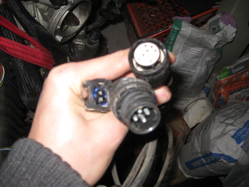

    Can I get rid of these plugs?
    The harness is from a 93 325 auto, there are 2 plugs that go with the O2 plug, I am pretty sure they are for the auto trans, just want to make sure before I delete them. Thanks in advance..

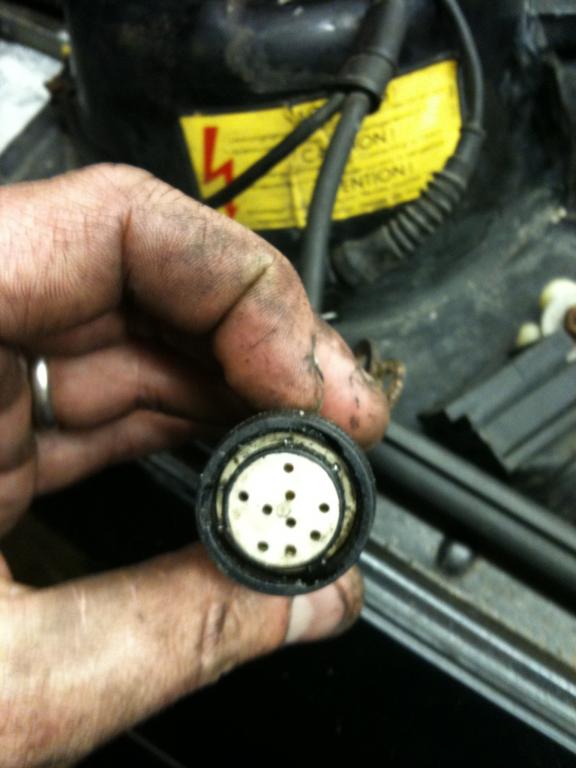

    The first one I have never seen before (and I've done a NV swap), could very well be the tranny. The second one could be almost anything. Could be the IAT sensor plug. Do you have the IM on yet?

      The motor is all in and running. These two plugs are with the o2 plug.

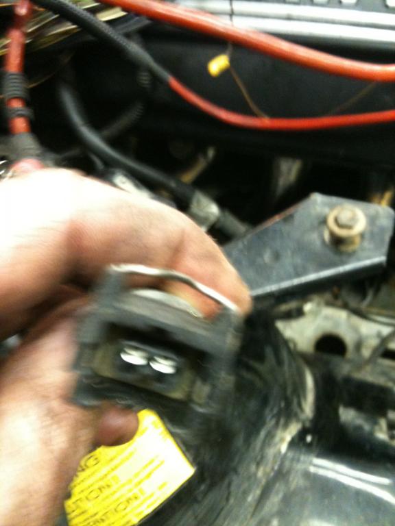

            never seen the round one with the white thing on it?!
            peel the rubber boot back and give us the wire colors on the 2 prong one, like mentioned earlier it could be many things, oil pressure sensor and IAT come to mind. also the purge valve

              round w/wight is for the auto trans
              the square 2 contact is for revers lights

              so yes you can get rid of the 2 plugs but not the o2 plug

                Round plug is for auto trans and the 2 pin is for the reverse lights. Get rid of them both. You need neither
