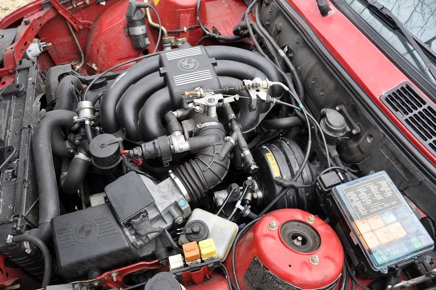

          I went with the e32 booster(same as IX booster) and e32 master. Im very happy with the outcome as far as my brake pedal feel and bite goes. The bias has changed a little bit for the better depending on your driving style. If you trail brake expect the car to get a bit loose as the bias has moved a little more to the rear, also the car stays relatively flat while braking and dose not dive as much.
          If i had to do it over again, i would change one thing. I would get a slightly different booster, maybe one from the v8 5 or 7 series, and mount it directly to the firewall as to not have the booster space out so far from the firewall. But i think that would require new brake lines as well.
          Here is a picture of my setup, im currently waiting for the 2002 reservoir to clean things up a bit.
          -Dan

            thats an odd looking M50... why the brake swap?
            Heres how mine looks
            Full Build Thread Here
            • bejbis
              • Dec 2008
              • 596
              Trying to prepare for the m50 swap, the more stuff I can do ahead of time the less i have to worry about later.
              -Dan
