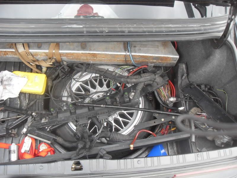

                        Found a Vanos OBDI wiring harness for a very nice price. Got a bunch of extra sensors and whatnot to make the swap go easier!
