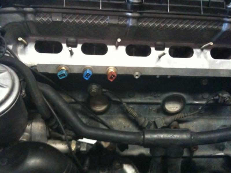

          here's mine.

              ok i got my temp sensor in and i expected it to be dark brown colored and have ONE pin inside of the plug.
              instead its a light tan color and has dual pins
              i ordered #13 PN 13621357414 in that picture because thats what everyone said to get when i searched the forums
              http://www.realoem.com/bmw/showparts...59&hg=11&fg=35
              yet i see in the picture above he has a brown sensor and it only has one pin in it.
              did i get the wrong sensor? it says its for an M20 according to the parts counter at bmw and has that exact part number on it in a sealed bag.

                  Shawn, you got the wrong sensor. One pin, dark brown. I think its #12.
