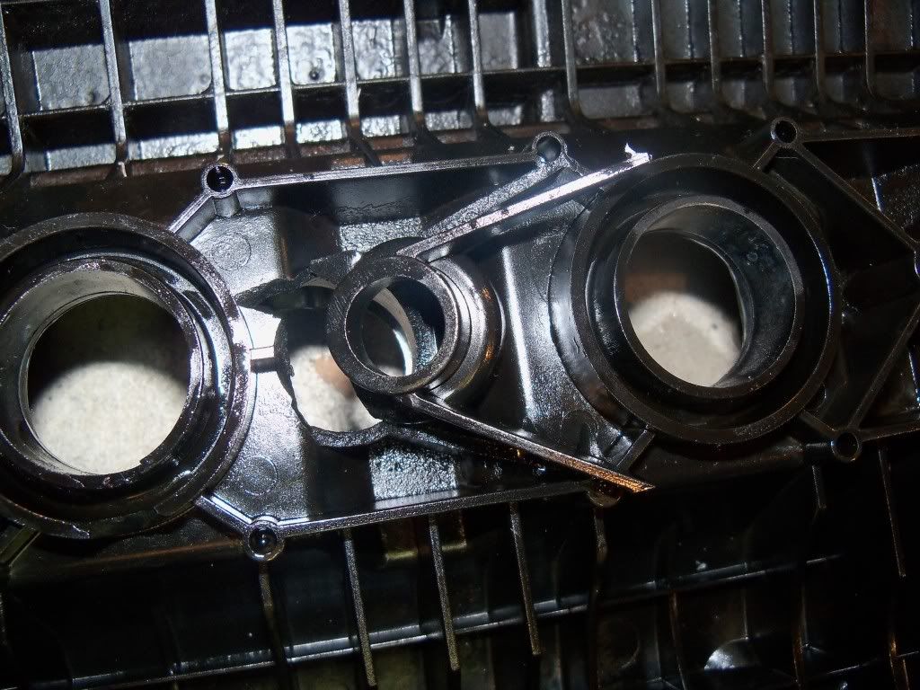

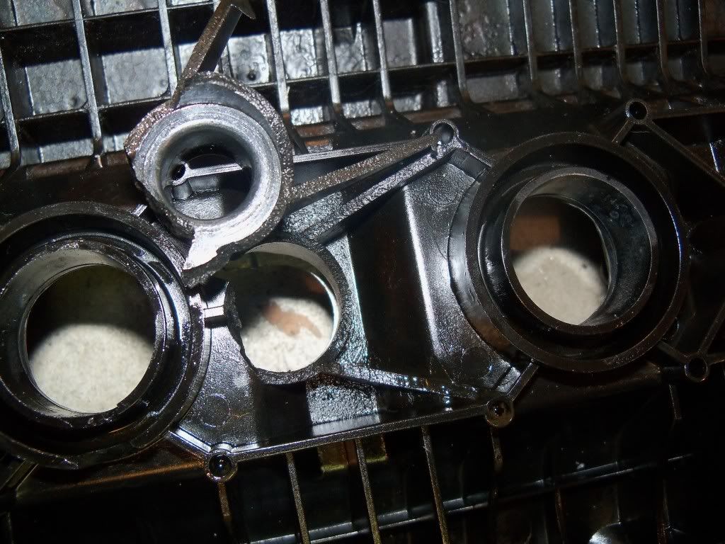

    This sucks, was kinda going thru the engine a little bit and stumbled accross this. Would you guys replace this? Any thoughts on glueing it? Anyone got one lying around they don't need? Thanks!

    yep replace it. the downfalls of the plastic valve cover.... the rubber gasket fuses with it and it breaks when you try to get it out :(

        Its not the seal... its the valve cover. Get a new one. Like Dominic said, the gasket sticks to it and when you try to remove it, its very stiff and brittle (both the plastic and the gasket). One or the other or even both will break.
