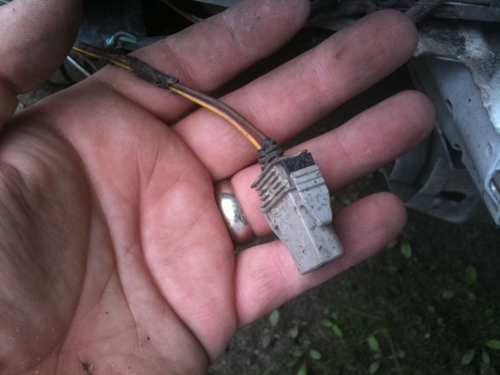

    So today I finally got a chance to start digging into the wiring and these were all of the connector that were unplugged!! Can anyone help me identify them so I can get this sorted out?
    And I did check out the wiring diagram pdf but it doesn't identify any of the connectors...
    1. DS
    2. DS
    3. DS
    4. DS - This looks like a fuse but it doesn't attach to anything!
    5. PS
    6. PS - This was BARELY connected to green/black wire in picture #4. But not attached to anything!
    7.PS
    Thanks for any help!

    Ok - from digging a little more I have figured out the lows are duel filament so the highs just aren't working and I'm just seeing the stock lows switching. But I didn't see a pair of connectors to plug into the "highs"...Yeah.....
    Also, #4 looks like it's the resistor for the aux fan. Which then I realized my fan isn't stock! :) Kinda looks like a spal but not sure...

    Ok - from BFC I found out the grey connectors are for the fogs (which I don't have yet); and the yellow plug is for the obc temp probe so I will ziptie that somewhere away from the motor...

      2, head light, 4, fan resistor, 5, horn Im pretty sure.

        6, corner marker

          Thanks guys, I got things semi orginized and plugged in the highbeams; so now when you turn on the headlights all of them come on! Ugh... Also on the cluster, the highbeams light stays on as soon as I turn on the lights.
          No idea why, gotta research it I guess...
