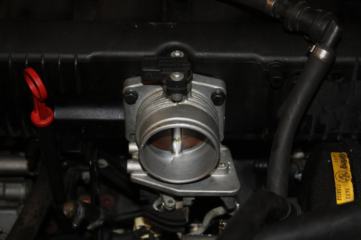

    Is this an OBDII throttlebody?
    Sooo why the fuck does my throttle body fit onto the intake manifold like this? (It is rotated 90 degrees)
    I can only guess that I was sold an OBDII throttlebody by mistake. Can anyone confirm this?

    What's wrong exactly? That's how mine looks, at least the best that I can recall. OBD1, that is.
      Thats an obd2 tboby. it should have a groove cut in it for the tbody gasket where the obd1 intake has the gasket installed in it, if they both have this groove they will not seal up properly as the gasket isnt long enough to span both intake and tbody
        Every picture I have seen of OBDI converted 24v's shows the throttlebody with the butterfly pivot on the horizontal axis so the tps and throttle lever are on the side.
        Thanks that answers the other question I had in my head, the gasket is very loose I was worried about that.
        I haven't even checked yet but the TPS is different on OBDII as well right?
        '89 Alpine S52 with goodies
        • chuck90m3
          • 568
          if i were you i would use the obd 2 throttle body. BMW updated the throttle body to make the switch more accessible so it can replaced easily. Just buy the bimmerworld adapter and another gasket and your fine.
            http://store.bimmerworld.com/obd-i-m...ptor-p658.aspx
            This is true. Though if you intend to run a charcoal canister, the OBDII throttle body lacks the third nipple for the fuel tank ventilation.
            Well, at least mine did...

              this is an obdII tb, and yes you need the tb adapter plate to run this tb on an obdI manifold have some in stock if needed.

                Woooops, my bad. I forgot the traction control part of the obd2 throttle body made mine look way different when I had it before.
                  that's what vacuum t adapters are for.

                    No time this shit is going to be running Wednesday come hell or high water. I ain't waiting for an adapter I bought an OBDI TB used and I'm having it over nighted to me.
