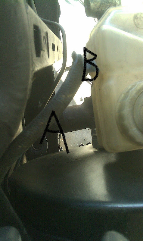

    Hey - I cant find my notes...:oops: I about got everything back together but am drawing a blank in a few spots...

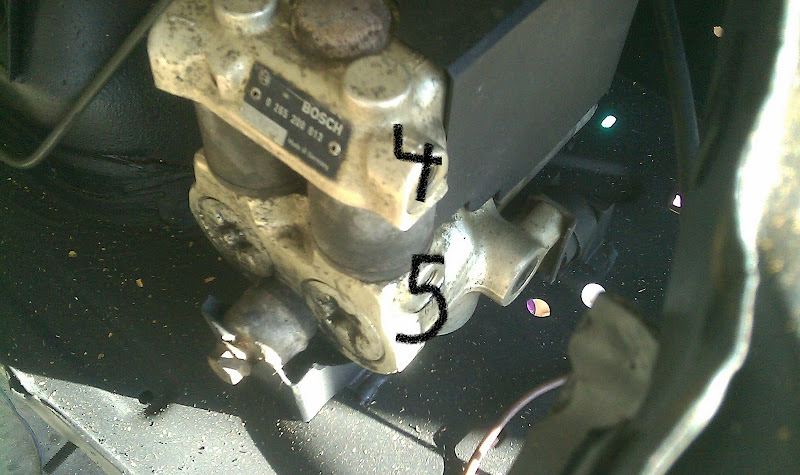

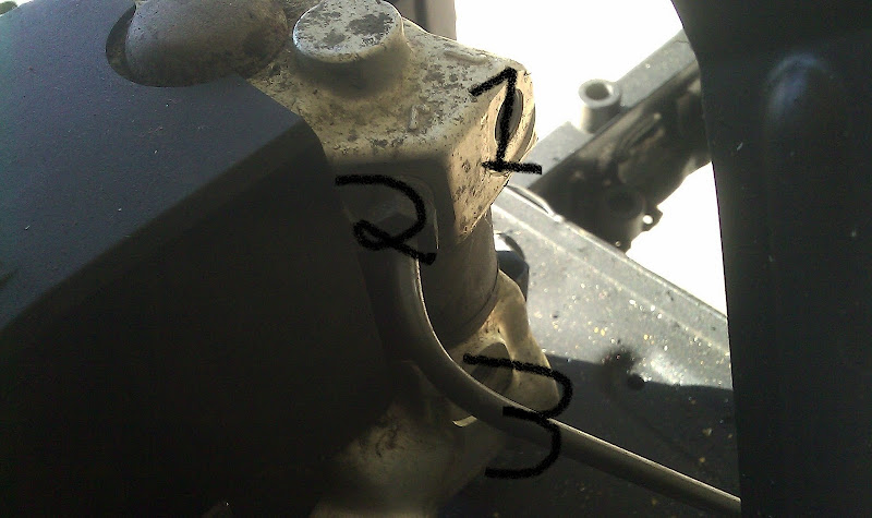

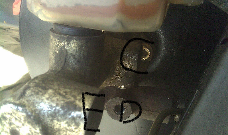

    I Dont remember how to plum up my ABS/master cylinder. I played with the hard lines but it just gets frustrating...
    If anyone can play 'connect the dots' I would appreciate it GREATLY (motor going in after this...). I can probably figure out which hose goes where after I know what connects to where...

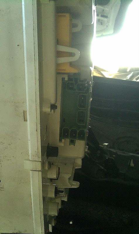

    For the cluster - the bunch of green male connectors behind the speedometer is bugging me. I cant seem to find what goes in there. I have a picture - but I don't think it would add any value.
    Cylinder -
    ABS:
    Cluster:

    More information -
    So no one assumes im an idiot...I have a 1987 325is with the stock brake bias valve. RealOEM does not show this part in the diagrams...
    I THINK I connect from the MC to the Bias Valve (C->D, E->F) then from there to the ABS (A->5, G->3). Then from ABS to Wheels (2-> PS Front, 1-> Rear Wheels, 4-> DR front).
    Green connector behind the instrument cluster is for Cruise and (since I dont have it) can be left empty.
    Any anyone confirm this?
