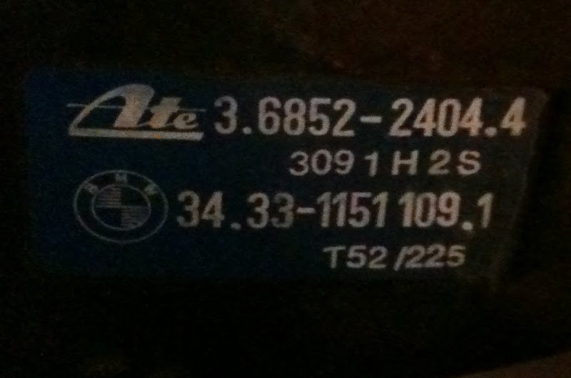

    Bought a E21 brake booster off eBay, came in today.
    Checked RealOEM, it's not the same part number when I cross-reference against any model year 1977-83 320i.
    Supposed to be 34331117549, but the unit I have is 34331151109.
    The VIN of the car the seller supposedly pulled the booster from checked out to be from an 11/81 production E21 320i.
    Here's a picture of the model number label on the booster:
    Anyone out there with an E21 booster have the same part number or confirm that this is the real deal?

    can you shoot a pic of the booster its self..

      What exactly...
      ... should I take a picture of?
      The brake pedal shaft looks longer than the stock E30 booster.
      What are the dimensions on the E21 booster?
        It is, it will need to be cut down and threaded
