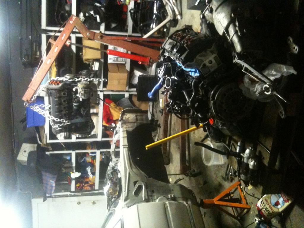

                  So i managed to successfully pull the engine. the car is sitting on 4 ton jack stands in the front and shitty 2 ton jack stands on the back, I have a professional 3000 pound engine hoist.
                  To pull the engine i first secured the engine on the hoist, then i unscrewed the engine mounts, removed the subframe with shocks rack control arms hubs all attached, lowered the engine enough to remove the transmission under the car, lifted the engine out and that was that.
                  all went very smooth i was shocked to tell you the truth.
                  one of my friends has been taking high res pictures on a really nice camera i will post some pictures tommo or sometime soon.
                  i am honestly so psyched right now words can not explain. i started at midnight and now 3 in the morning and just finished. idk how im gonna make it to class tommo!!!!!!
                  thanks everybody for the advise and suggestions hopefully this new engine goes in just as easy as the old one came out

                    i just took a pic on my iphone for now better pics to come
