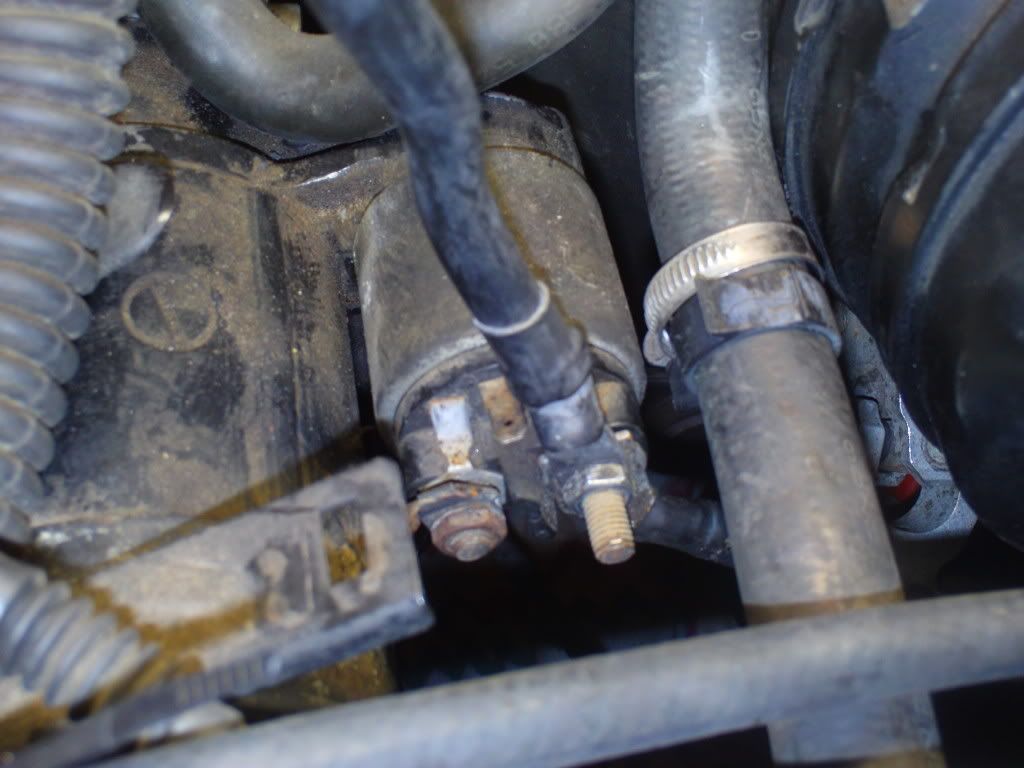

                      Question...I've pulled of the IM already and I want to make sure my starter wiring is correct. I did have 12v at the post on the starter but there was no audible click when I turned the key. Is there supposed to be another wire on here? (early starter)
                      • boyd_dave
                        • 42
                        ya. should be another wire that tells the solenoid to load with key turned. do your power windows work with key on?
                        • Wishno87
                          • 6025
                          Your missing a few wires. Check out my thread.
