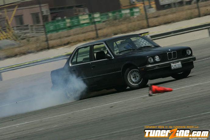

                            Dude I beat the shit out of my 240(see photo above)and it took it. What killed it was running something over on the road and cracking the case, which caused it to leak oil. I still have it though, and would use it again if i can fix the crack:)
