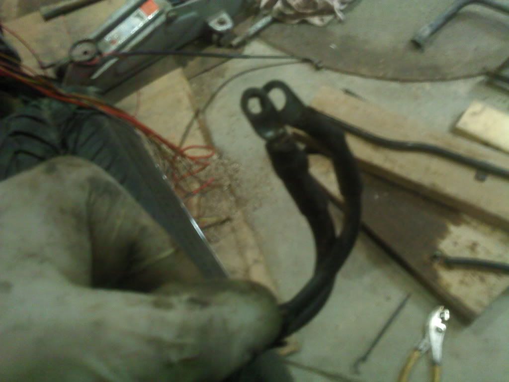

    So im trying to figure out where some wires go.
    1. Where does the positive wire off the alternator go to, does it go to the same place as the positive going to the starter solenoid?
    2. Where do these 2 wires go, there coming out of the fuse box?
    3. What are you guys using for the passenger side coolant hose for a m42 radiator?
  • Reckless_Havoc
    • 156
    That is how mine is connected and it works great.
    I believe those go to the power distribution on the passenger side of the car. Should both be 12v pos.
    A little searching will get you additional info. These seem to be common 24v swap questions.
    Good luck!
