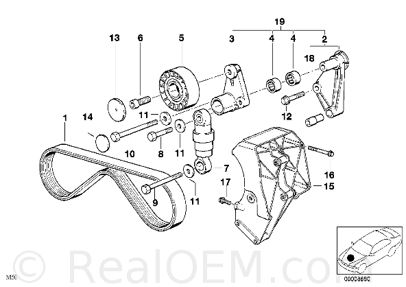

Removing A/C condenser bracket/aluminum block- How to?
    There is one bolt in behind it I can NOT for the life of me figure out how to get to. What am I missing?

      if memory serves correct...its behind the main pulley, which has to be removed
      '87 325ic, powered by S50.
        4 in the pass side of the block, 2 in front of block behind vibration damper.
          FFFffffuuuu I really don't want to take the pully off haha I was hoping there was a way to avoid that. Thanks, guys.

            I snuck it out on my s52 (with the pulley still on) with a ratcheting wrench.

              I tired that, fitting the wrench in the slot on the crank trigger but no luck. Maybe a few well placed whacks with a hammer will break the brittle aluminum? Probably easier to remove the pulleys at that point though haha.

                I pulled mine without taking the pulley off. It looked unlikely at first but there is enough room to do it.
