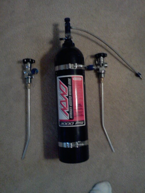

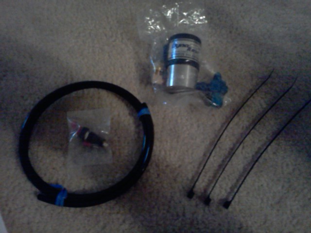

              Just ordered a NANO kit instead of a heater I can't deal with the inconsistency. I am also waiting on my new dynotune master blaster purge kit then onto some tuning and dyno sessions.
              For those that don't know what NANO is check it out

                Well look what was waiting for me when I got home!
