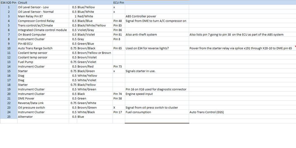

Unrelated but your ABS is wired kinda screwey and pin 3 in the CC regulator not a/c bump. pin 3 X20 on e34 should be the ABS power wire, large red/white stripe. Here's a break down on the E34:
