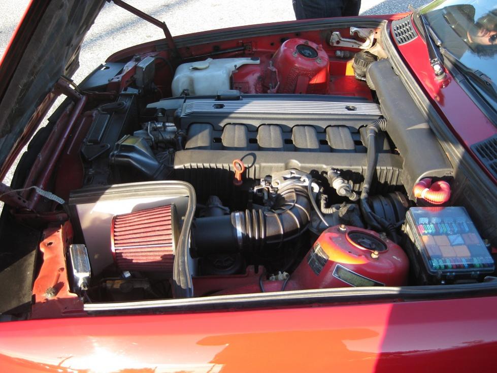

                          Gather all of the required parts for the swap then devise a plan of attack and you will do fine. There is more than enough information here and at e30tech for you to complete the swap yourself. Do everything you can to the motor prior to taking your old one out to save some more time. Prior to my swap the most I had done on m car (or any car) is suspension and brake work. I'm not in a related field of work at all either. It's a lot of fun and very satisfying once completed! Also, make yourself an adapter harness to start with so you can easily make alterations to it should you screw up the wiring at all ;).
                          *edit*
                          Motivational pictures added :)
                          Seccond night of the swap:
                          How it sits a year later, not many visible changes:
