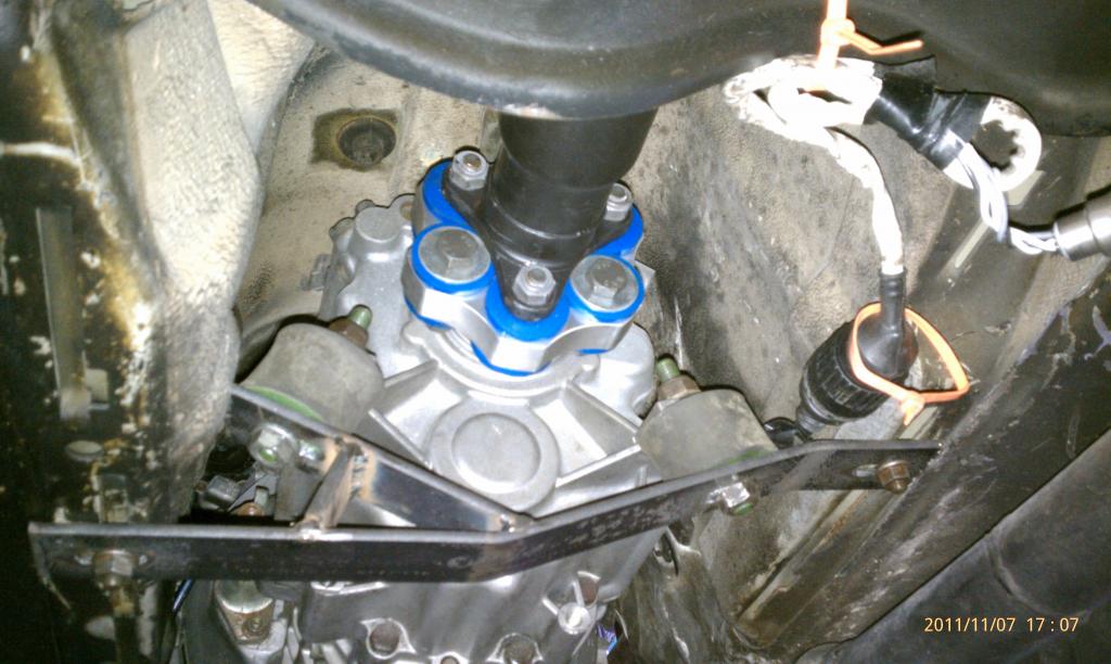

                            Ok.. so I put the White325is modified trans brace in the car.. and it's still vibrating. It is a much different vibration, but a vibration none the less. Now instead of 25mph, it starts at 35-40 and up. It is a much tighter vibration.. more like a buzzing..
                            I will get pics of my mount/guibo and all that up later.
                            I think I may go to oem tranny mounts..
                            My 1991 318is Progression Thread

                              • Nairb
                                • 1214
                                Here is a pic of the setup so far.. do the green mounts look too tall?
