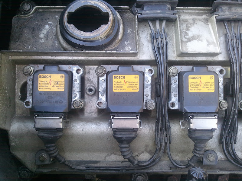

    Based on what was available to the E34 it’s a M50B25TU. So it has VANOS, which I was skeptical about but I think I can get over it as long as it doesn’t go out.

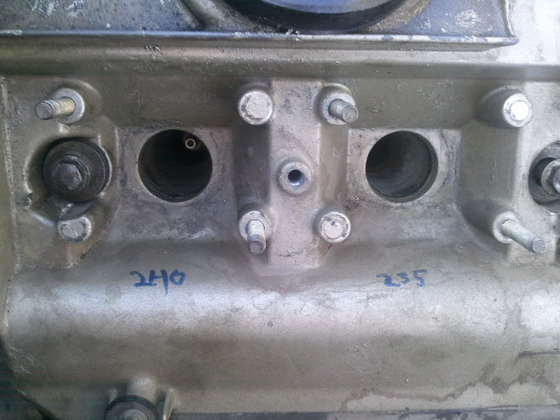

    Also looks like a mechanic wrote down the compression readings on the valve cover. Lowest is 235, highest is 245.
    1 - 235
    2 - 235
    3 - 245
    4 - 235
    5 - 235
    6 - 240

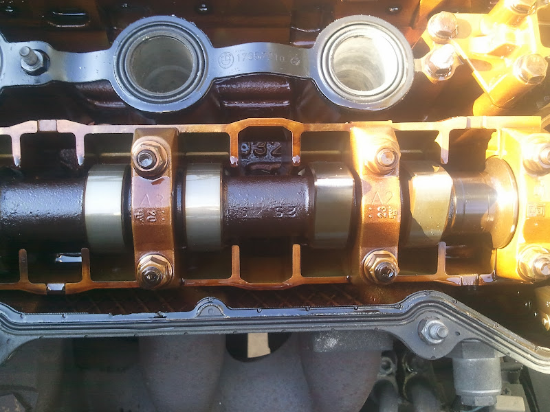

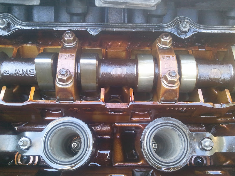

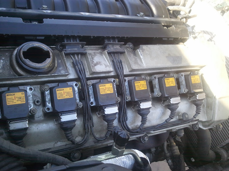

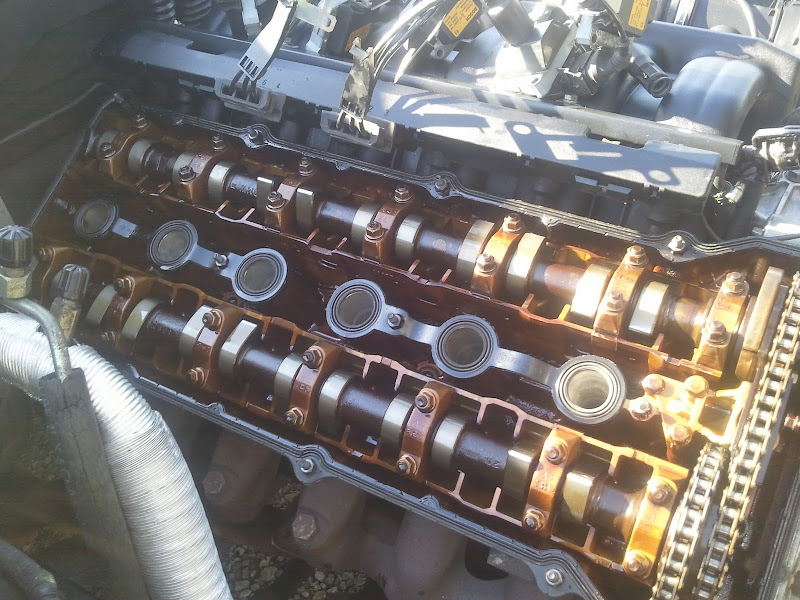

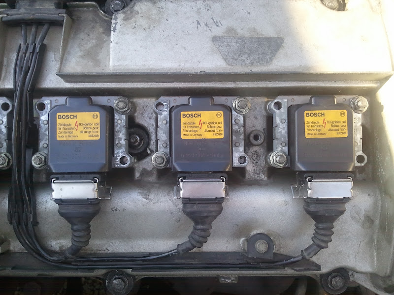

    Here are some pics of the engine, please let me know if you don’t think its worth pulling and/or have input that will save me some time tomorrow.

    I dont see anything there that would scare me. Beware of the reverse Torx bolts holding the engine and trans together. you will need the proper tools to remove these.

              IMO that motor looks pretty well cared for and the comp results if true are great. What's the price?

                    Oh hell that's worth it even for the oil pan pick up and dipstick! You better grab that the head looks good enough to use for sure. That's a $500 part!
