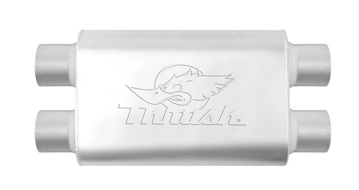

        I'm a huge fan of Vibrant's products. 2 of these should do the trick:
        Or you could just get a cheap dual in, dual out muffler from Summit:
        Free Shipping - Thrush Welded Mufflers with qualifying orders of $109. Shop Mufflers at Summit Racing.

          Originally posted by e30polak
          i'm a huge fan of vibrant's products. 2 of these should do the trick:
          http://www.verociousmotorsports.com/...sonator-12-oal
          qft!
          Always Always go for the reach around if there is an option
