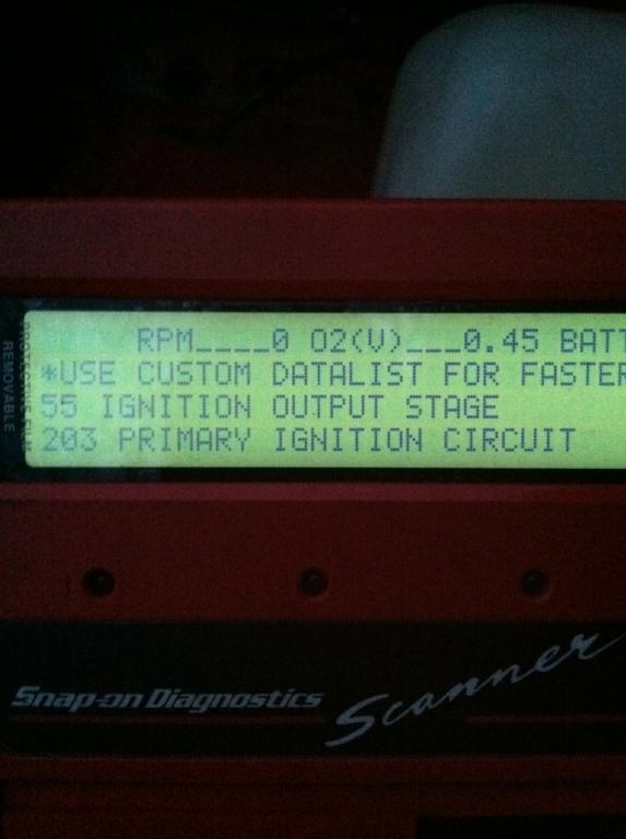

    Me again with another No Start
    Well this morning I went to the car and it started right up but immediately died, thought nothing of it since I have a feeling my IAC is on it's last legs and doesn't hold the smoothest idle. Proceeded to start the car and car didn't want to start, the fuel pump primed everytime I tried to crank and not even a sputter, the car just kept cranking. I stopped cranking after I smelled fuel which I knew that meant that fuel was definitely getting to the rail. Took out my scan tool and sure enough 2 codes came up, one that has come up before and a new one I haven't seen yet. Codes are listed in the picture, once the car started, it had a very rough idle for about 20 seconds whilst surging from idle to 2,000rpm and back. Thoughts? Would a faulty ICV cause this? Or an Ignition switch? My CPS was just recently replaced along with the cam sensor and those have been checked and are within spec.

              Bump, i tried a stomp test before clearing the codes and as it initiates to read codes i flashes once and then there is a long blink and then it shuts off, what is that?

                      Problem is ignition related, looked into the codes. Now to go through the coil wiring.
