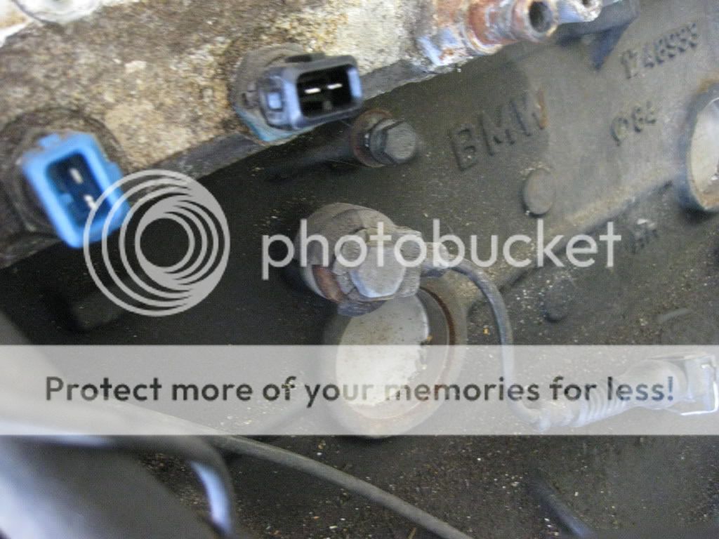

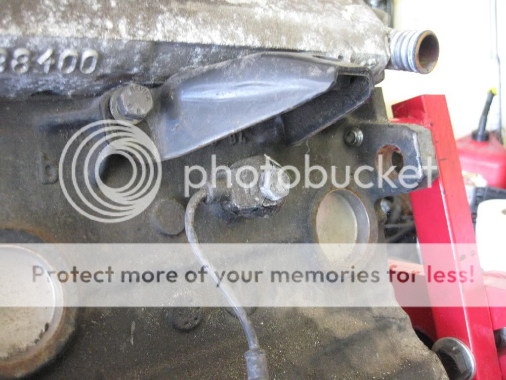

    Where do you guys mount the knock sensors on your blocks?
    My S50 is in the car and everything, but I can't seem to find pics online or in the Bentley of where the actually sensors are mounted/oriented.
    Any photos/help is greatly appreciated. Thanks

      Wishno has it, there are threaded pads on the block specifically for the sensors.

        ^Thanks a bunch!

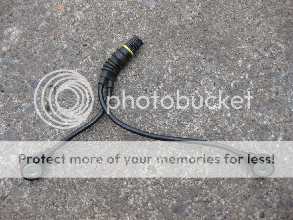

                  Oh and M50s and S50s have two. OBD2 cars have both built into a single plug.

                    Note that OBD II knock sensors are very reliable. Jordan/Stuck has been converting them for use on OBD I cars, so it's possible to use the better and cheaper sensors. The downside, though, is that you have to do some wiring adaptation.

                      Oh wait, I was told the dual obd2 knock sensors worked with obd1 harness.
                      Did he share that info on how he made them work with obd1?

                        You need to make an adapter harness or add two plugs, or cut up your engine harness.
