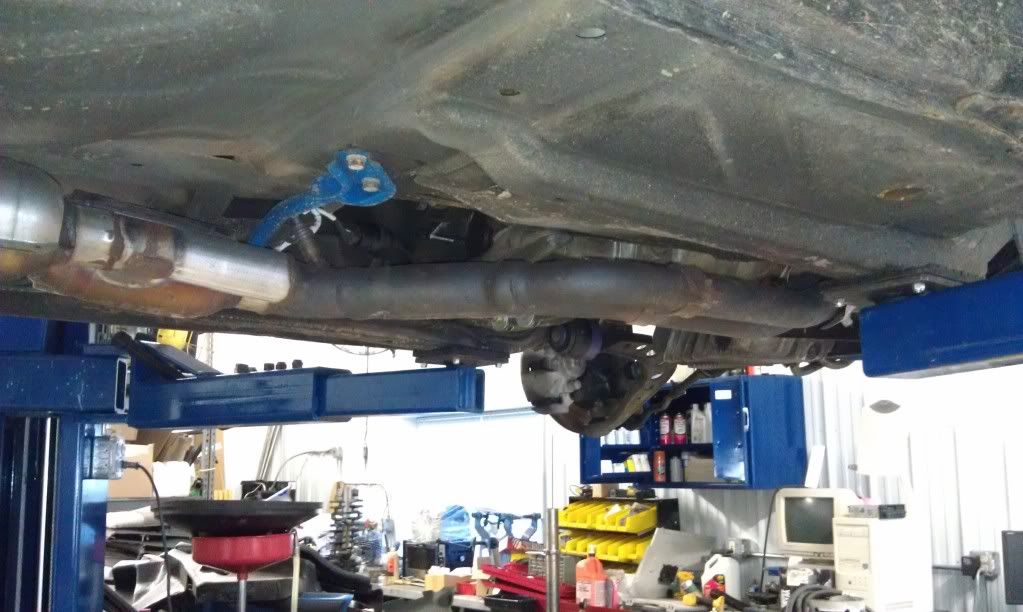

            Really? the seller had a picture of it clearing by a decent amount, he took them down as I basically have *dibs* on it.

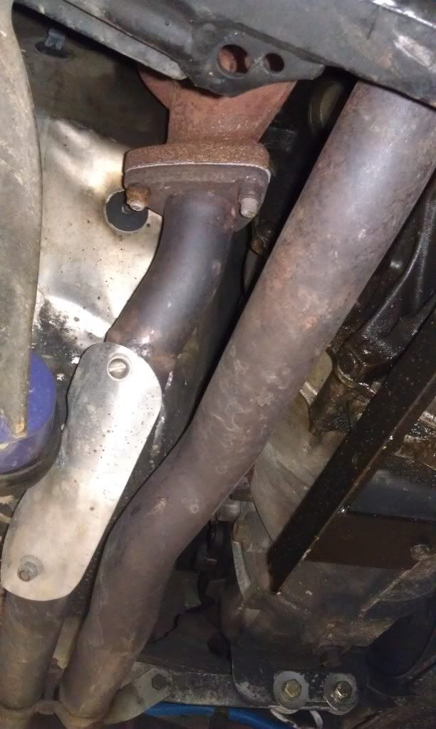

                Here are a few more pictures of the exhaust on the car, seller had no problems with any rubbing or interferance of any kind.

                  Look closely at the first pic. First off you can't see where it hits the subframe and Also notice something else missing that the exhaust will rub on?
                  F swaybar.
                  This isn't my first rodeo.

                    I can see a weld done by the small plate heat shield he most likely moded the down pipe Iam selling right now a remus muffler and manifold we simply moded the s52 manifold instead of the down pipe

                      Picture was after he sold the swaybar, it doesn't bother me, I can modify them if need be.

                        I will say mine originally rubbed the subframe and I eventually took it back to the exhaust shop to have it modified / welded for better clearance of the subframe.

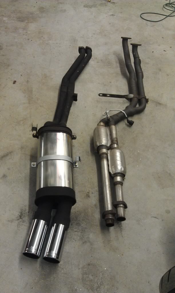

                              Well I have the exhaust in my possession and I will have manifolds by the end of the week and will be installing it, It seems they follow the same angle as my ebay headers (Duh!) which shouldn't be too bad considered I barely had to shim to motor. Will report back!
