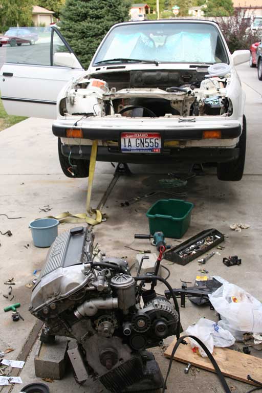

As for posting pics of my car-
Here is one ;)
Its really not that bad- My engine is in again... I'm still fitting sds and the process is a bit slow with the weather/my ambition. Tomorrow The wiring harness will be done, as with the vacuum system hopefully. I have no interior in my car right now- that'll go in thrusday along with my vibration dampener (with trigger magnets) and hopefully it'll be running by the end of the weekend. I've still got to get some spark plug wires made. I'll get some pics of the random things i've done up here after while.
