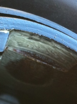

    So I installed my aux fan and let the car idle to a decent temperature to test the fan switch. When i was done I was poking around. I took off the oil cap and saw a milky residue towards the top of the valve cover. So immediately I'm thinking head gasket. I proceed to check the oil and Coolant for any evidence of mixture. None. Both clean.
    Is this normal?

      How long has the s52 sat? I'm betting it's just moisture buildup.
        What Farbin said.
        You're in the middle of a swap right? It's normal.

          Perfectly normal operation for an S53.

              HAHA. S52.. Damn, flaming well deserved. No more R3v from my iphone. Between this post and one from yesterday, i have had my privileges revoked.
              Yes, im actually at the tail end of my swap. The motor has been sitting since last October and today is the first time i actually brought it to operating temp. (well as hot as it can get idling)
              Im thinking its just moisture to. I just wanted to double check. Thanks for the responses.

                its just moisture
                • Bimmerman325i
                  • 6854
                  If that gunk is still there in a week after swap is finished, or if the temp climbs past normal, then you know it's a head gasket. Otherwise it's just moisture.

                    better to be safe than sorry for sure, especially when youre at the tail end of your swap. might be a good idea after about a week of driving to do a fresh oil change.

                      just moisture, happens to m52s and s53s alike

                        Second that. Happened to my m50 and S50.. After the engine gets good and hot,it will go away
