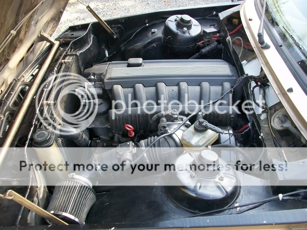

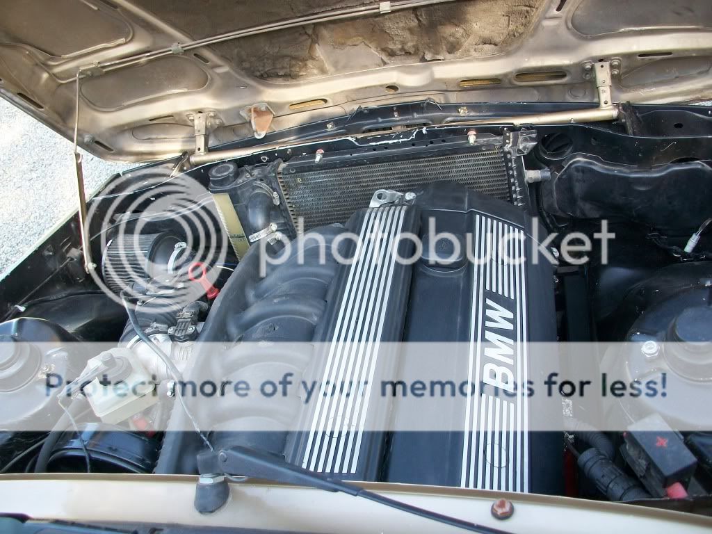

I modified the harness (of course ;) )
G260 with G250 Clutch/Fw
Trans tunnel didnt need modifiying (motor is far forward)
Motor Mount arms were done by me. E30 323 Euro pass mount and a modded E30 M42 drivers bracket. Coupled with my 24v motor mounts. Stock M10 subframe.
