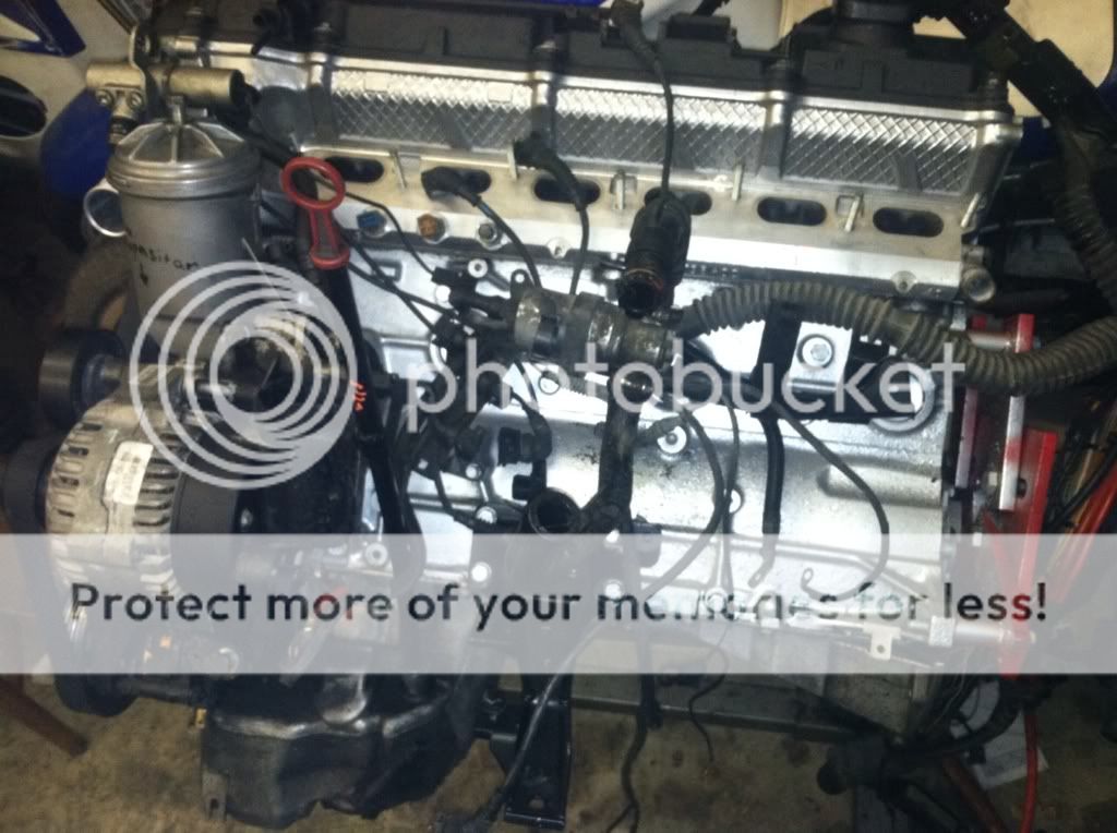

    I have started the car and hooked it all up BUT I went to bleed the motor today with coolant an I noticed it idled at 3k I check for vacuum leaks and plugs the ones I found but the I discovered that my TPS isnt plugged up, so my question is where is where is it at on the engine harness ?

    Pics will be up later, I'm just on my phOne At the moment

      Same harness as the one from the icv. Just follow the icv harness and it will take you to the tps plug

        Okay I will do that and if I find it that way I will report back to seek if I found it

          http://i381.photobucket.com/albums/o...3/cfaa47eb.jpg
          http://i381.photobucket.com/albums/o...3/787d5fe0.jpg
          Just follow the ICV connector? Or what?

            Dude stop dicking around, pull the boots of the connectors, match up the colors to a chart that you will find if you search.
            From e30dohcwiki:
            So, you have a bare engine. Don't freak out, it's not that hard to wire up the engine. Each wiring plug has a rubber protective boot. Pull this boot back and examine the colors of the wires going to each connector. The colors of the wires will tell you which sensor the connector plugs into.
            oil pressure sensor BRN/GRN or BRN/GRY
            front coolant temperature sensor (ECU) BRN/RED BRN
            rear coolant temperature sensor (Gauge Sensor) BRN/YEL BRN/VIO
            crank position sensor YEL
            cam position sensor YEL RED/WHT BRN/ORG
            VANOS solenoid RED/WHT GRN/BLU
            knock sensor, 1-3 BLK NCA DME PIN 70
            knock sensor, 4-6 BLK NCA DME PIN 69
            throttle position sensor (TPS) BRN BRN/BLK RED/YEL
            intake air temperature (IAT) sensor BRN GRY
            idle control valve (ICV) WHT/YEL RED/WHT WHT/GRN
            Evaporative emissions valve BRN RED/WHT
