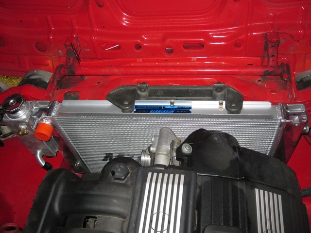

          THAT! I'm welding a ZA aluminum tank m42 style to a mishi e36m rad best of both worlds

                Not yet, it's still in the plans though. I don't foresee it being an issue. I would have done it by now but I want to be at the shop with the car and motor in so they can fit it without issues coming up later

                      I got my tank welded for those who are interested. Even better, they're detachable brackets that secure onto the rad. Small, nice looking solution with more capacity than the m42. I'm happy with it, it's not a cheap solution though.
                      Not the greatest pix
