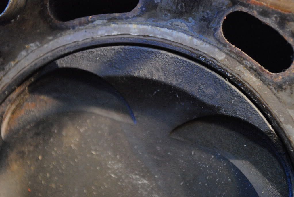

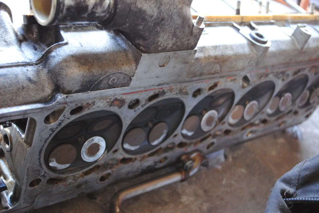

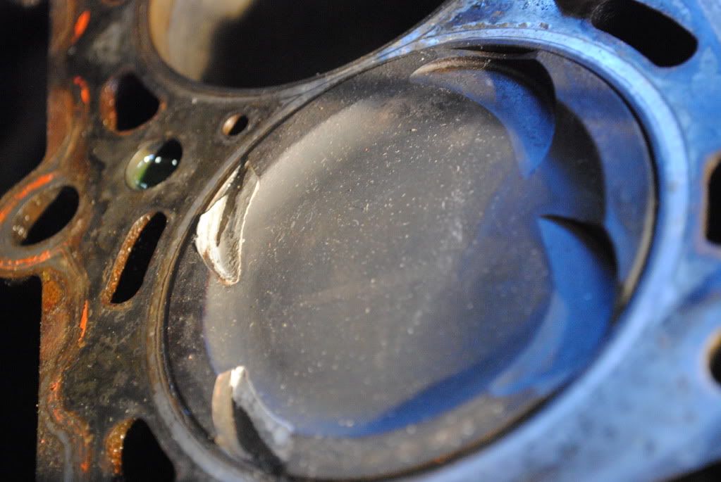

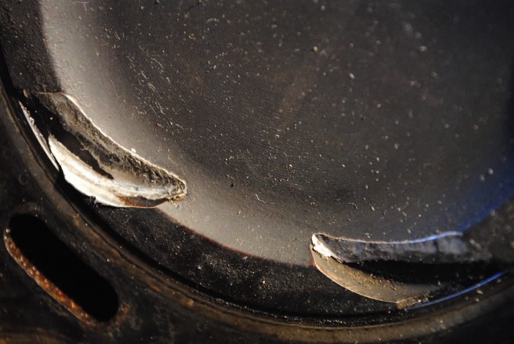

    so on to the pics of the carnage. The motor was bought from the U.K.- some numbnut put the vanos on with bathtub clear calk and either overtightend 50% of the bolts to where I snapped off a few, or left the others so loose that the timing chain swallowed a cam retainer nut, skipped a few teeth on the exhaust cam and bent all 12 exhaust valves- all at about 130mph.
    exhaust cut out, all of the pistons look just like this.
    intake

      that's what I was hoping to hear. Did an M20 many years ago with a quick new head, but the car was sold shortly after, so no idea what happened months down the road. did the piston crown look anything like these?
        The bottom end should be fine-- I've never had a problem with head/valve replacements in this situation. Seems like valves are pretty soft when the piston is moving that fast.. Like you know, just clean up the exhaust valve reliefs as those sharp areas would be nasty hot spots when driving.

          what do the cyl bores look like. When i tapped (and broke) a few valves the damaged piston reliefs scored my walls to the point of no return.

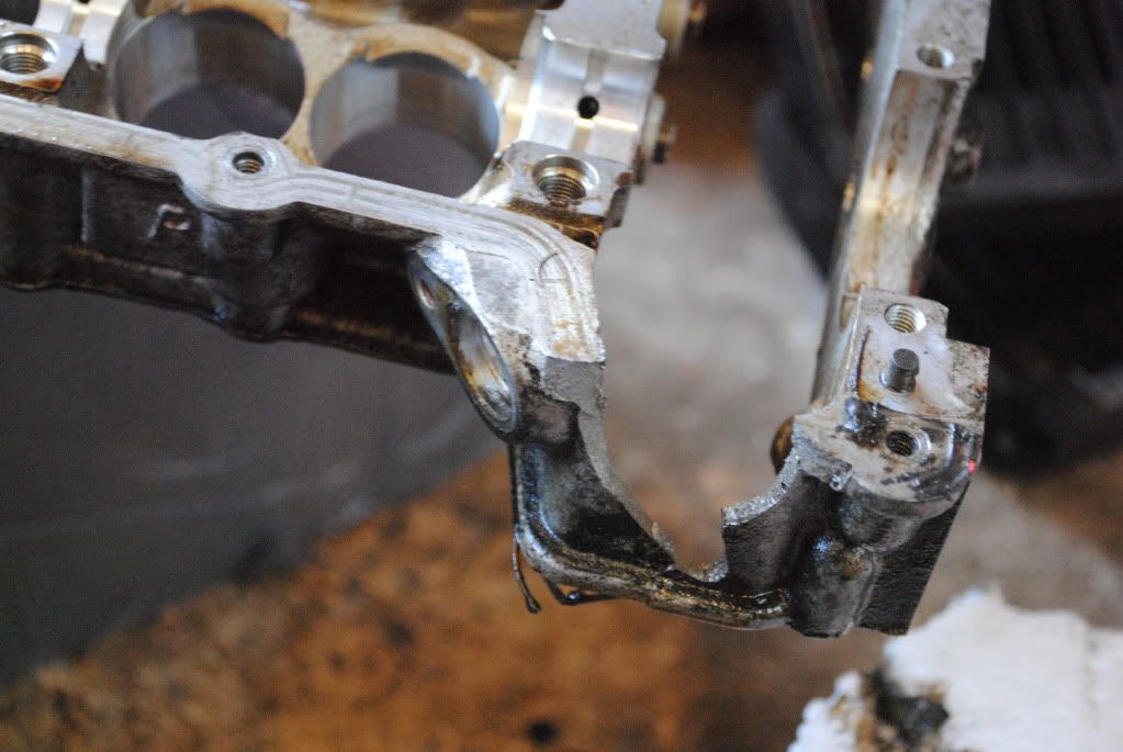

          you need a new head from the damage, but why cam trays?
          also, last time i skipped teeth on the exhaust cam it was because my oil pump nut fell off and i seized the exhaust camshaft from all the heat.. That was at about 110mph turn 10 at PBIR when i had no oil light or oil pressure gauge. I basically ran a lap or two without oil. That resulted in the exhaust camshaft also totally breaking in 3 places and 3 cam tray caps broken. Also a valve embedded (more like explosion welded) itself upside down ontop of a piston. It was all so....beautiful.
          i can see that needing new cam trays. i think you need a bunch of valves and a new head. look at your bores then decide if you wanna use the current pistons.

            ^^His cam tray is broken in the picture (didn't know if you saw that).
              nop, missed it : p. you do need a cam tray hehe
