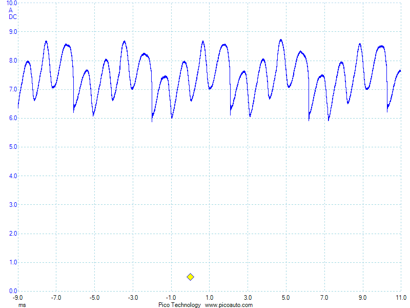

    Look at the fuel pumps at idle with an inductive amp probe and a labscope then pinch the fuel line a little bit to make them work a little harder.
    If one pump's waveform looks erratic, replace it. You can also look for a failing pump to draw more amps under load.
    Failing-
    Good-
      well there ya go!
          Failing-
          Good-
          Good idea,
          Do you use a pico scope? I am considering upgrading my current scope and the pico scopes seem pretty nice.

            I had a pico 2 channel a few years back, but I found the Vantage Pro and an older Vantage worked better for my automotive needs once I outfitted them with 10 foot leads and a few extra accessories. The pico gave great data in my bay but was cumbersome to test drive with due to having to drag the laptop along.
            The Snap-on is an expensive way to gain waveform data these days though, so if I was shopping for a portable scope now I'd probably check out the new uScope from AES. It and a low amp current probe can let you try out some basic waveform diagnostics for under $500
            uScope
            The low amp probe I use for current draw, injector tests, fuel pump tests, ect. is below.
            Current Probe
