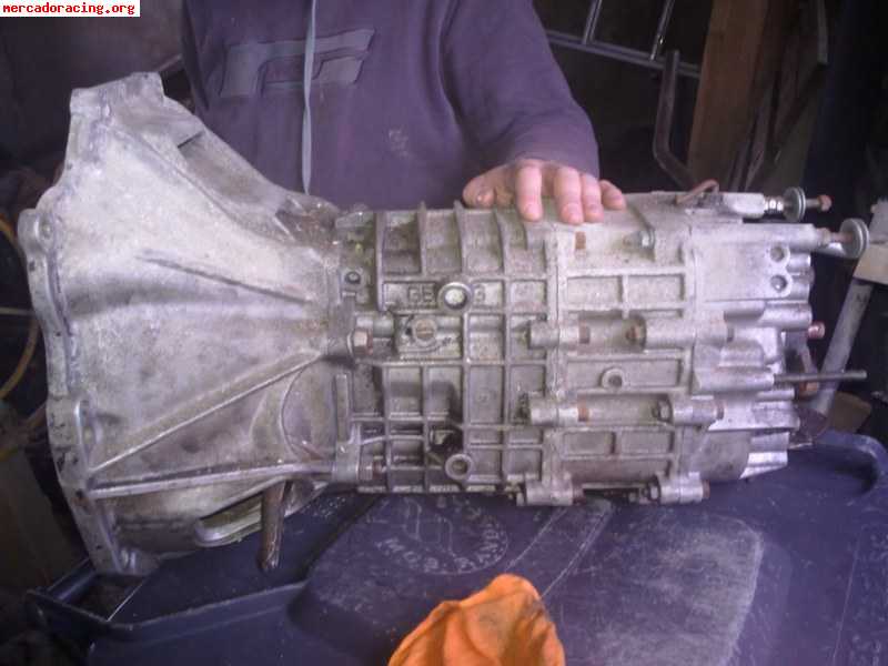

        i think M50s came with the G250 not the 260 ...
        maybe this should help to be sure what you got
        G260
        G265
        G250
        Never heard of a G255 tbh. Hope it helps.
