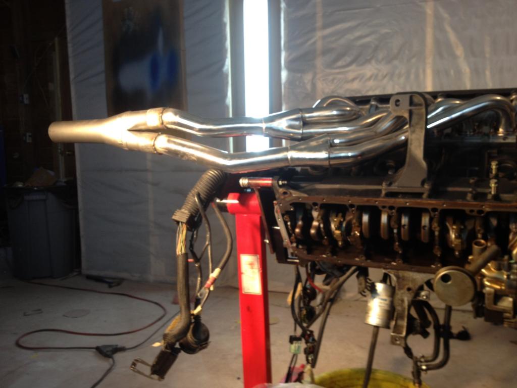

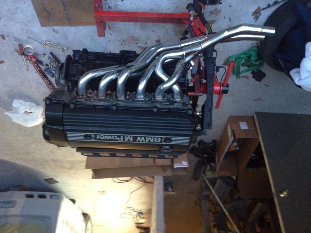

              • eurosport22
                • 210
                i have these. i put them on before i dropped the motor in and it was fine. 2 washers under the passenger side motor mount and the cleared the crossmember fine. oh i also welded on the flowmaster y which comes back perfect and im gonna have the exhaust shop take it from there. flowmaster p/n from jegs is y200250
                http://www.jegs.com/webapp/wcs/store...chTerm=Y200250
                ill post up a few pictures when i get to my other computer tonight
                • singh336
                  • Dec 2010
                  • 211
                  pictures would be great, jegs site is down for now it says ill check later tho
                  • eurosport22
                    • 210
                    you have to hold that adapter up and find the angle and have to cut the pipes a little bit. but heres how mine turned out. page 2 of this thread shows how to set this up nicely. Janderson has a nice write up on it
