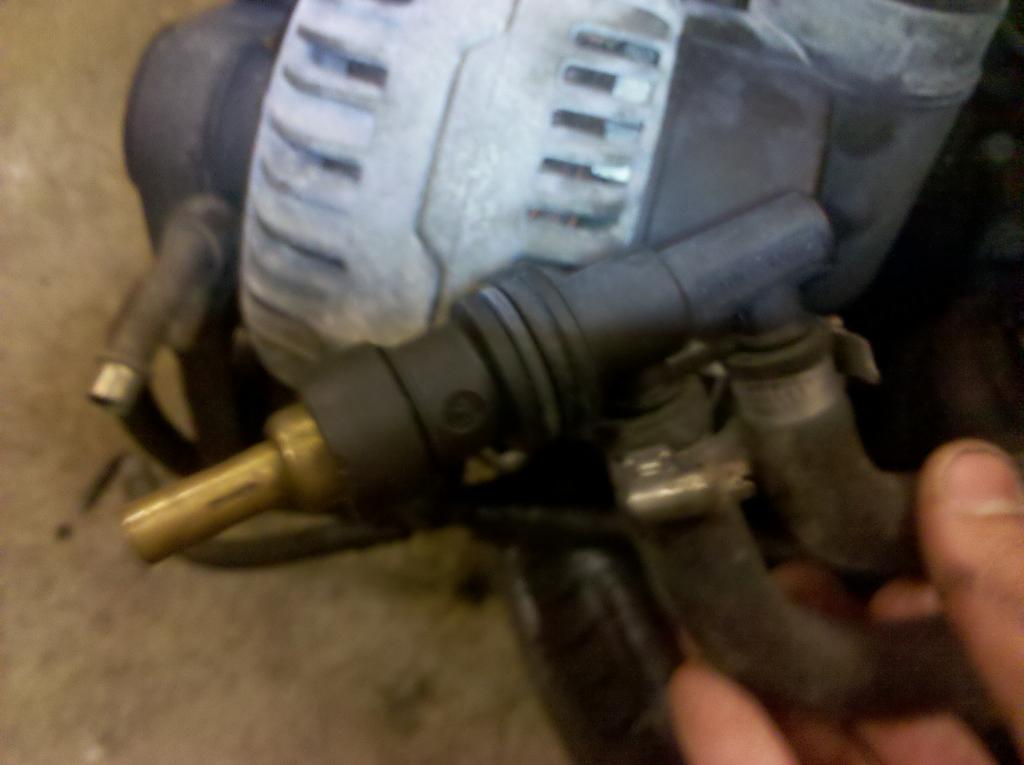

    In the first attached picture, BMW calls it a thermostat, but I have no idea where it goes or what it actually does.

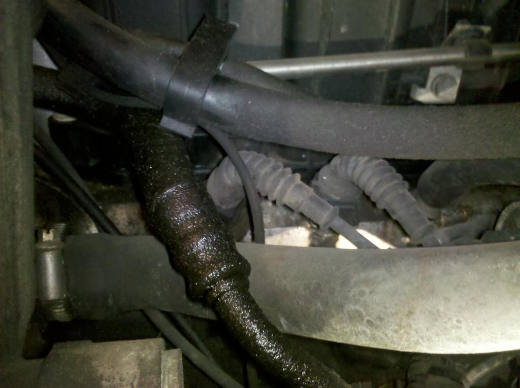

    The next one is what I think is the temp sensors. which one is which, and what has to be replaced with the e30 one and what wiring mods need to be done?

    the first pic is a thermostat for the throttle body heater. i cut mine off and routed the hoses on the other end to recirculate. i have the bimmerworld smooth 3.5 elbow.
    the second picture. replace the second sensor, the one to the right or closest to the firewall. assuming its a m50tu then it should thread right in.

    youll wanna run the 6131136427282 thermo.
    you have to cut the metal band off and take the screw out. slide the black cover of and it will fit through the hole. put the screw back and put a zip tie where the band was
