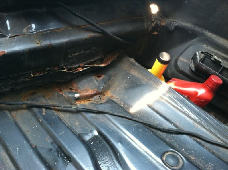

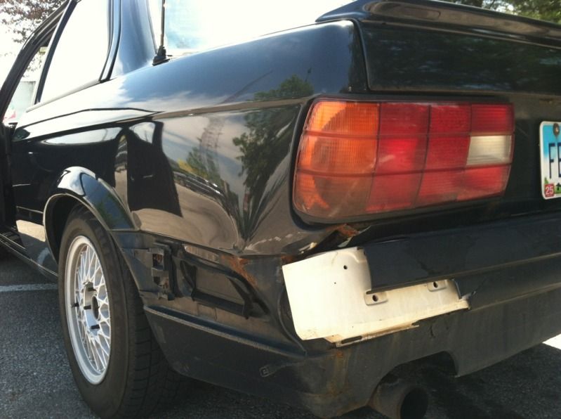

              Went and looked at the car today. Had been recently rear ended. Rear was all sorts of fucked and had been hit previously too. Quarter panel and trunk floor were creased. Had some rust here and there. Interior was not real good. Engine ran strong but you couldn't give it much gas in 1st or 2nd because the guibo was so bad it was rattle around and vibrate like mad. Slave cylinder was going out on the clutch. Swap itself looked decent, wiring wasn't super clean but wasn't a mess. He still wanted $6k for it but said because of the damage he would do $5k......sorry but for that I would expect at the least a straight body free of any potential serious damage. He was a super nice guy but just a bit off on price. Kinda bummed but oh well.

                lol, that sounds like a $1500 car.
                • Wishno87
                  • 6025
                  +1 you should be able to buy a really nicely put together M50 car for 6k.
                  • Jand3rson
                    • 37587
                    I would have run screaming like my hair was on fire from that car.
                    • e30austin
                      • 15382
                      You couldn't give me that thing.
