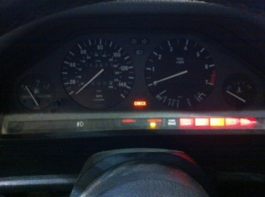

                okay i posted those pics from my phone let me explain..
                was trying to show the dash lights when the key is on

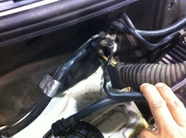

                then i took some pics to show what i had hooked up to the block on the firewall for hot power

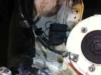

                and then i showed my grounds... i grounded (temp of course) the engine hook bolt to the shock tower because my pass control arm is broken where the ground strap is supposed to go, so i'll make something later for that.

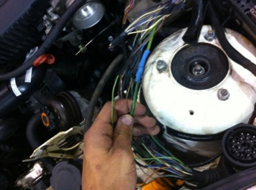

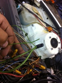

                then i showed some pics of my iginition wire which i don't see where two wires go into one on either side, i just see two wires further down the harness that won't make a difference if connected at all...
