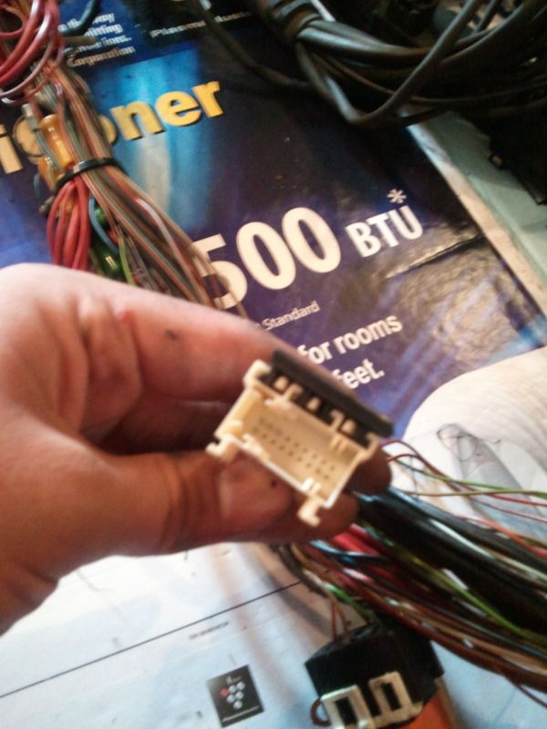

      I have two connectors that I am completely stumped on... Well one, the other one I haven't really thought about yet.
      Anyway here is the one in question:
      It has I think a total of 5 wires.

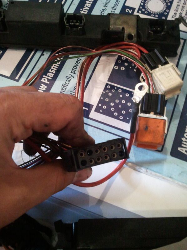

      The other one is this:
      Haven't really looked around too much for that connector.

        The two connectors are located near the Relays. I only have 2 relays there, I figured there would be 3 like the E30...?

          never seen those before. And im oretty sure you need three relays. youre missing a blue one.

            Yeah, they are both optional. White one was to do with ASC crap, the black one is something for an transmission module, guess this was an autotragic harness now. Also a 95 harness.

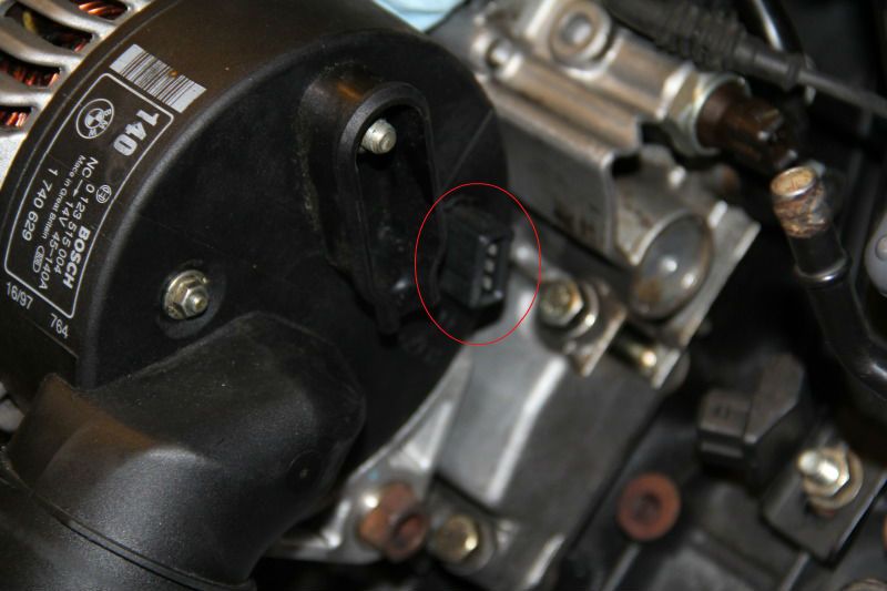

            What plugs here!
            Everything I have is already labeled, the only one I am not sure of is the one I have labeled oil level, which is a Blue/Yellow, Blue/White, and Brown/Orange wire, all small.
            Any ideas if the E30 has a voltage sensor somewhere else that goes to the dash and this one is not necessary.

              Alternator exciter wire will plug into that connector. The E36 had a stud with an M6 nut on it, whereas the E39 had the 3 pin plug. The center pin is where you will need to connect the blue exciter wire.

                Ah, thanks!
