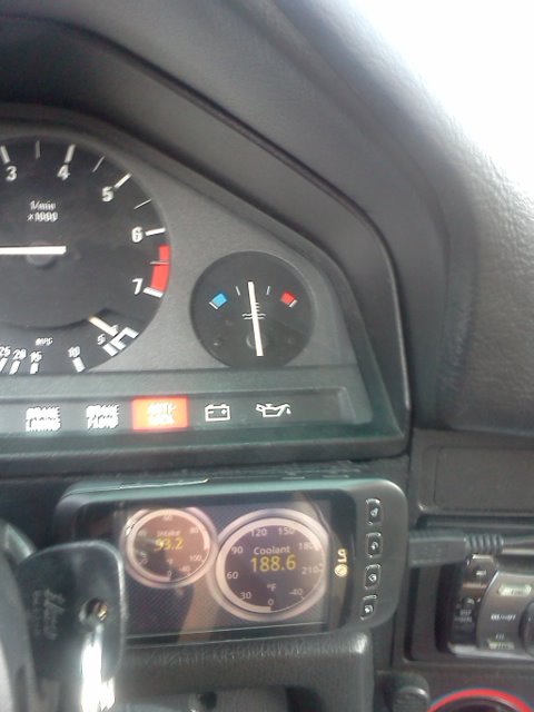

              Sorry about the quality of this picture, but this is the actual temperature the ECU is reading from the e36 sensor.
                Right, but the e36 gauge is buffered. The needle shouldn't move for a certain range (ie 160-210 F). The e30 sender is unbuffered, and he's trying to figure out what temp each of the lines are.
                Midwest Spec E30 #64
                https://www.facebook.com/thestickergarage
                  The gauge above is the e30 gauge reading from the e30 sender and the gauge below is reading directly from the ecu from a e36 gauge. The e30 gauge is slightly buffered towards the middle my picture is at an angle but the center line is about 200f. I have seen as high as 212f and it is below the next line up but still on part of the temp symbol. I like the real temp gauge idea a lot it would be great to have but the sender needs to be in the right spot for it to be accurate. Jrkroupe if your 188f fan is going on and your using the factory sensor it is on the cooler side of the radiator (the outlet) and will go on well after the engine itself is a higher temp. I have separate pullers that have a 185f sensor on the inlet side of the radiator and they go on well before the regular auxillary fans go on. You might want to invest in Carsoft it will read real time data for the OBD1 cars. I'll try to notice where the gauge sits on the lower temps when I start out from cold if that would be helpful. I have also put this on other cars and they run slightly higher temps like 206 to 212 normally and can spike to 220 sometimes. My e39 540 that has a 105c!! thermostat as standard runs 226 normally which seems crazy to me but that is normal for it and it has 280,000 miles on it. I think they do that for emissions more than anything. Hope you find your answers.

                    Just checked this morning and the next line down from the middle was about 165f.
