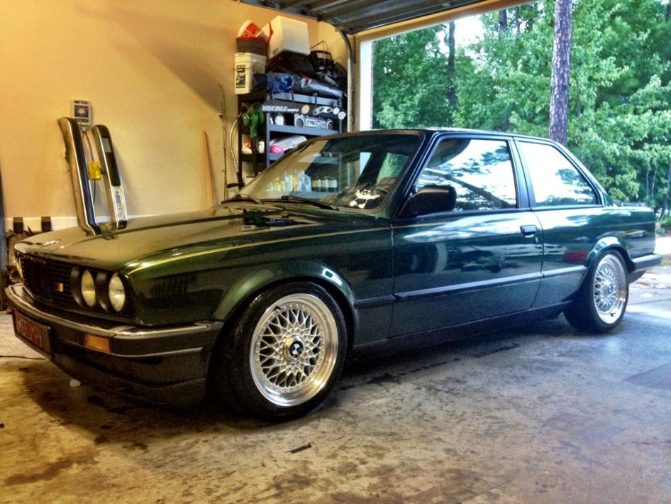

                Well the car is finally working after going through utter hell to figure it out. It turns out it was a bad unloader relay and a very temperate main relay. Both working together to piss me off. Unfortunate that I ripped the entire car apart only to find out it was that simple.
                Im actually convinced Dave is just magic. Because he called me and suddenly the car started working. Thanks for your magical powers Dave. Hahaha.
                Courtesy sexy shot below Click image for larger version
