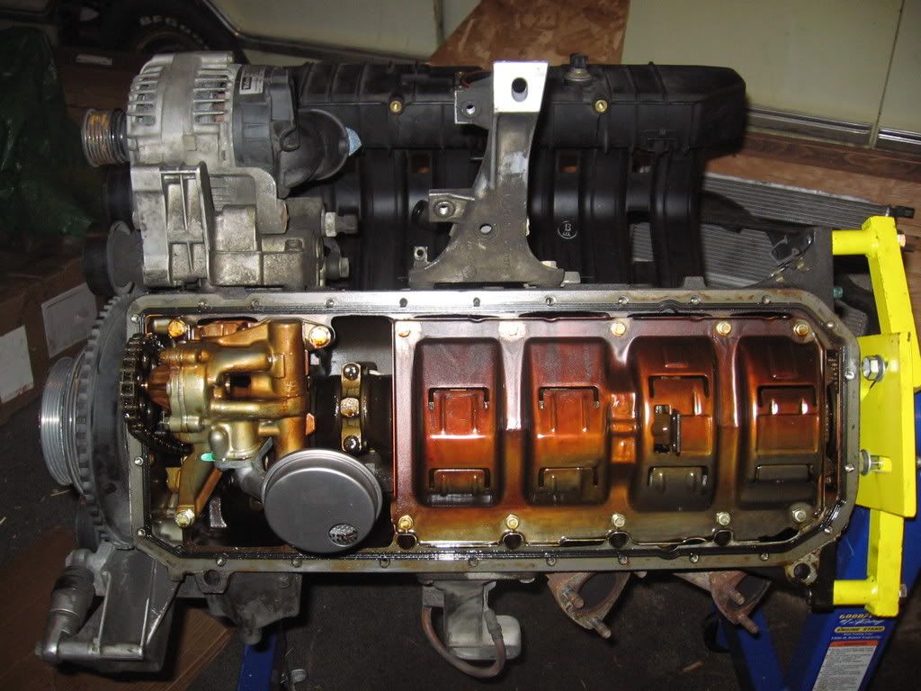

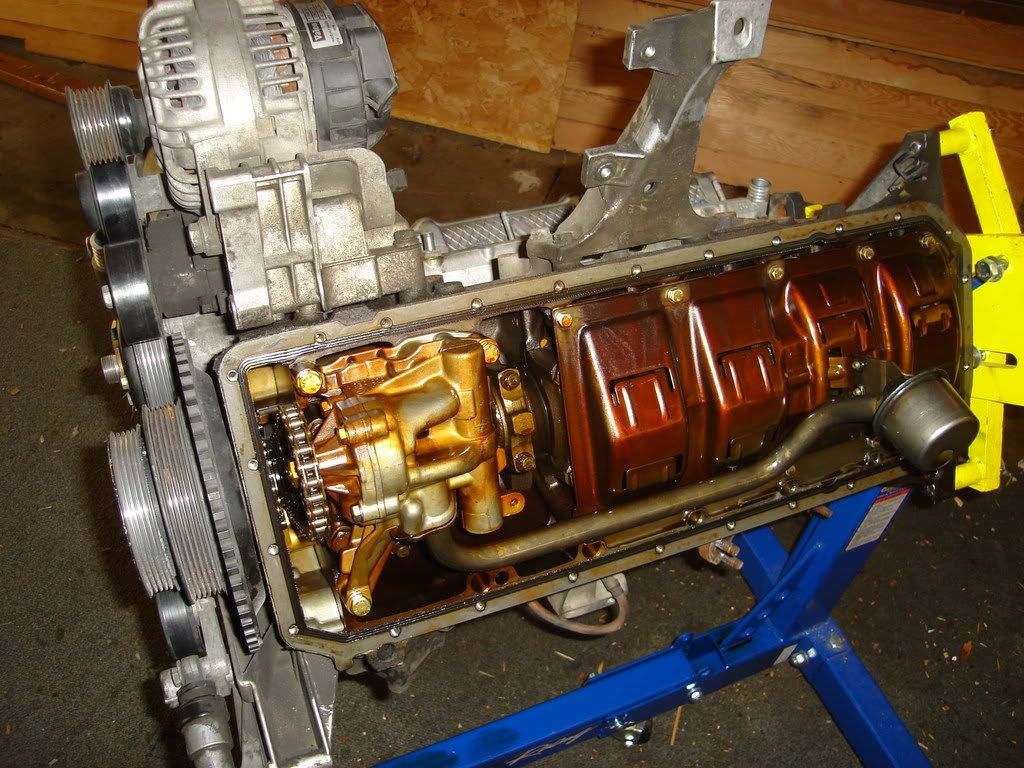

                        Here is a pic of what you need to do.
                        You need to go from this
                        To this
                        Also for guys who have done this also corect me if im wrong because i dont want to have done this wrong but the E34 pan went on so im guessing its right.

                            • matt
                              • 3732
                              You're not done yet in that pic, bud... you need to take off the windage tray bolted to the block and take off the pickup support bracket for the e36 pickup that's bolted under the main cap bolts.
