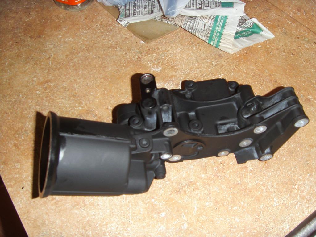

    Hello guys, Can anyone of you Knowledgeable tech's help me with this one.
    I have an s54 oil filter housing and I would like to swap my m52 housing out for the s54 housing.
    Does anybody know if I have to change any parts? Like for Ex: alternater, or belt tensioner from m52 to s54, assuming both engines have the same architectural measurement in belt drive. I did see the tensioners are different..
    Are there any clearance issues with oil cooler lines? any pics would help

    Retap one of the back ports for the vanos feed line. Job done :D

      re-tap isn't necessary, VAC motorsports, Bimmerworld, and possibly others sell an adapter bolt that does the job. $30 and done.
      in to hear others' experiences.. but from what I've researched here and on bimmerforums, it's a direct swap aside from the vanos bolt.

        retap>$30 part

          Unless you have no taps / no drills and are afraid you will mess up!
