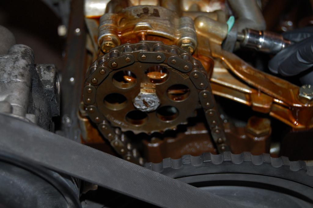

                  Also I've been curious about the oil pump lifespan. Doing a search oil pump failures always leads to the backing off of the nut. Does anyone know if 180k oil pump would last? Since that would be the #1 potential engine failure. Replace it for the piece of mind? I appreciate the input.
                    you can drill the nut and basically "cotterpin" it, weld it, or locktite it. Im gonna red locktite mine, and see how it holds for my swap. GL!
                      I didnt have enough room to drill thru the nut so I just JB welded the Holy fuck out of it!

                        You don't need to drill it yourself. Just buy one from bimmerworld for $10.
                        Anyway my question wasn't about the nut. It's about the pump itself.
