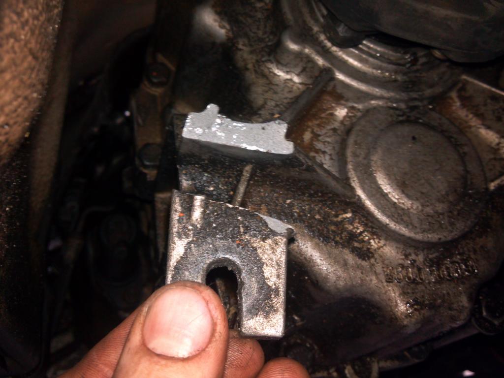

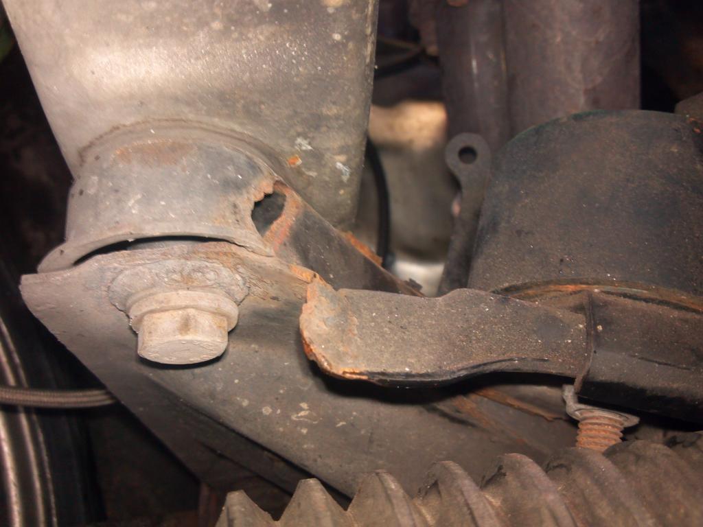

    Found the passenger side motor mount ear broken clean off the subframe AND the drivers side transmission mount ear snapped off the tranny (the tranny I just bought)
    I guess with the mount sheared off, the engine tilted and my through bolted UUC trans mounts didnt "give" enough and broke the trans itself from the "twist"
    Also explains why my fan kept kissing the lower passenger side of my radiator. wish i found this sooner.. shoot. time to weld in reinforcements on my spare subframe.. and hopefully TIG weld this trans back together
    pics to come

                    • bimmer630
                      • 1228
                      We are just starting to learn the TIG welder at the shop.. I havent even touched it myself but The guy I work with is getting good at it and were gonna take a shot at welding that thing back on.. Hes only so far messed with stainless ..
                      Any tips for getting a successful weld?

                          • 328ijunkie
                            • May 2007
                            • 3961
                            replace that subframe please.
                            Check Us out on Facebook
                            Needing a harness adapter or wiring help? Check it out: also have 24v motor mounts, E30 M3 covers and E36 ECU mounts!
                            Full Product Line Tuning
                            OBD2 Tuning Available! OBD2 E36, S54 Swap, S62 Swap, etc: tuning@MarkertMotorWorks.com Dyno Thread
                            • Exodus_2pt0
                              • 5943
                              Why? A properly repaired sub frame with a good weld will be stronger.
