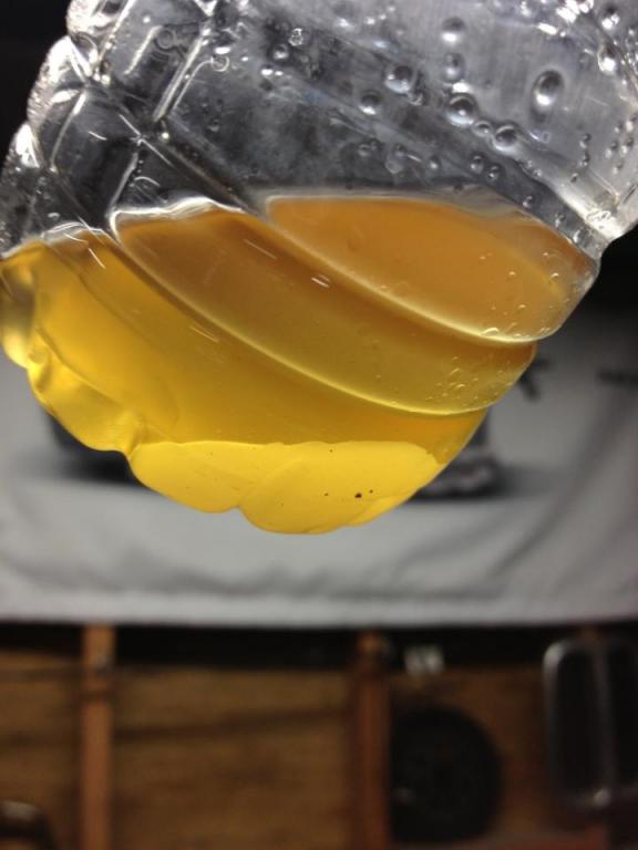

    Here is the gas, might be the cause. Getting a couple pops

      very easy to find out if its a gas, just spray some starter fluid in intake if it starts... then you know
        Yea that is next thing.
