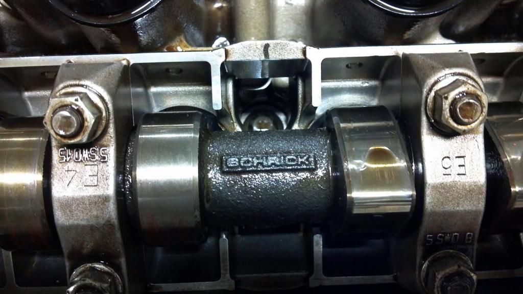

    Heres a photo of the shrick casting on the cam that I was surprisingly greeted by when I popped off the valve cover

      Looks like it was running OBD1 although thats a funny looking crank sensor...

        that is exactly what my OBD1 crank sensor looks like. So I'm thinking the engine was converted to obd1. Just convert the rest over anyway. OBD1 is a good route to go, especially for turbo

          Cam specs are as follows:
          Intake - 264 degree, 11.2mm lift
          Exhaust - 256 degree, 10.6mm lift
          1100$ cams. They are said to increase mid - high end power.

            Sell me your schrick cams :)

              Wow thats a prime find my friend
