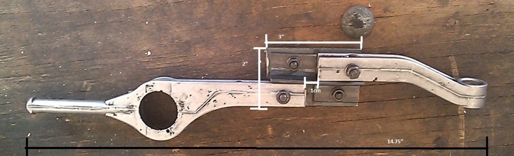

                      I used the shift linkage that i had been using with the m50 g260 combo and now the whole thing is rotated way towards the drivers side. Besides twisting the actual linkage which id rather not do how have you gotten around this problem?

                        • jink0619
                          • 808
                          very excited for you man, about the linkage, i cut the shifter arm in half moved it over and welded back like in the pic. Make sure you measure it on ur car before you weld.

                            ok just the stock e36 zf linkage?
                            (or any short shifter made for that setup?)
                            The best one-stop shopping for German car parts and lifestyle: http://www.gutenparts.com/
                            • 325e10
                              • 161
                              correct, the g260 linkage has to be twisted to make it fit correctly. Swapping back to the e36 zf linkage will solve your issue.
