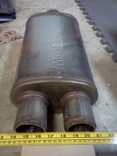

                  Magnaflow makes two reversable dual 2.25" to 3" mufflers. I have used both. The 14" #13278 was too loud for my taste and then I went with the 18" #12278 which is way quieter. these worked well on my s52 w/stock s52 headers some crappy and cheap Imco converters. This makes a pretty quiet and decent system for not too much money and worked with my 318is rear valance.
                          Do you have pics of measurement for the outside of the 2.25 tips? My calculation shows it to be a minimum of 6.25" outer tip edge to edge with nearly 2" in between.

                            The two 2.25" measure 6.75" outside to outside and have 1.5 " in between them. This is a picture of the small Magnaflow but they are the same in that respect. Hope that helps
