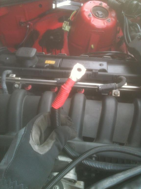

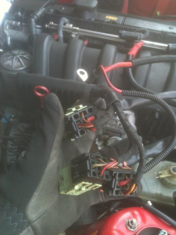

I have most of the engine wired up but the last few large cables, with ring connectors, I am not sure what they bolt too. The large red cable i know is battery 12v but does it go to the starter or the remote battery terminal on the intake? I already have a large red one on the starter but wasnt sure if its the right one or if the one pictured is. The small red cable that supplied 12v to the three relays i am holding, where does it bolt to, and one of these relays is missing do i even need all three? Lastly i dont have a pic unfortunately, but on the passengers side of the engine harness do all the large ring terminals with red tape on the end just go to battery 12v+? Thanks for the help.

Small red goes to the battery tray junction for 12V+ the large one goes on the starter, I remove the old M20 one (batt cable)and use the e36 one. So you sould have the large wire going to the starter and the wire from the alt going to the starter also.I have most of the engine wired up but the last few large cables, with ring connectors, I am not sure what they bolt too. The large red cable i not is battery 12v but does it go to the starter or the remote battery terminal on the intake? I already have a large red one on the starter but wasnt sure if its the right one or if the one pictured is. The small red cable that supplied 12v to the three relays i am holding, where does it bolt to, and one of these relays is missing do i even need all three? Lastly i dont have a pic unfortunately, but on the passengers side of the engine harness do all the large ring terminals with red tape on the end just go to battery 12v+? Thanks for the help.:nice:Originally posted by 325Projectzdon't listen to the diagram... listen to mr. swiss. -
So is the large red wire i have on my starter now supposed to go to the intake manifold + terminal and the one in the pic to the starter? Or both to the starter and just not use the E36 + terminal since i am using the E30 terminal on the passangers side of the firewall?Comment
The wire in your hand needs to run from the junction box on the battery tray to the starter, then the main wire from the alternator goes on top of that before you put the nut on.:nice:Originally posted by 325Projectzdon't listen to the diagram... listen to mr. swiss.Comment
